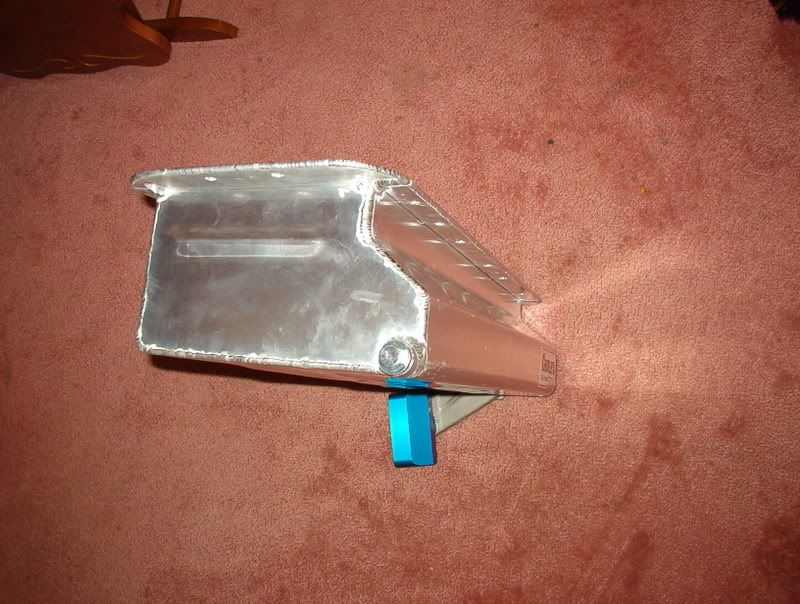

Anyone ever run a 31151 pan? I'm currently running a deep sump single line pan but since I've changed the steering over to a rack I now have room to put this pan on and go with the dual line swinging pickup.

Here is a few pic of the Charlies pan from my Dragster/Indy engine. You can see the trap door in front of the swinging pickup. BTW this pan was cheaper than the Milodon
what does the charlies pan use for a windage tray
the milodon has a built in windage tray and crank scraper. i believe the milodon is for 4.3/4 stroke. it works fine in my 4.150 stroke

That Charlie's pan looks like a nice piece. I don't think it would fit on my Alterkation since the front is not cut back any. I have not had any oil control problems with my Milodon, having pressure never go down below 50psi after letting off at the traps. But if the Charlie's fits and is cheaper it sounds like a good buy.
Charlie's Oil Pans does make an oil pan to fit the Alterkation, Magnaforce and LRT front ends on A Bodies. I currently am running one with a single line and swinging pick up with no issues on my 73 Duster. It is a 7 qt. pan and is a very nice piece for the money.
Pic #1
