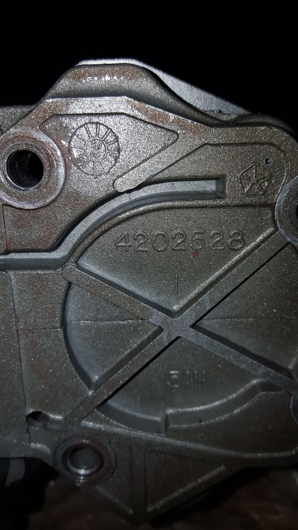

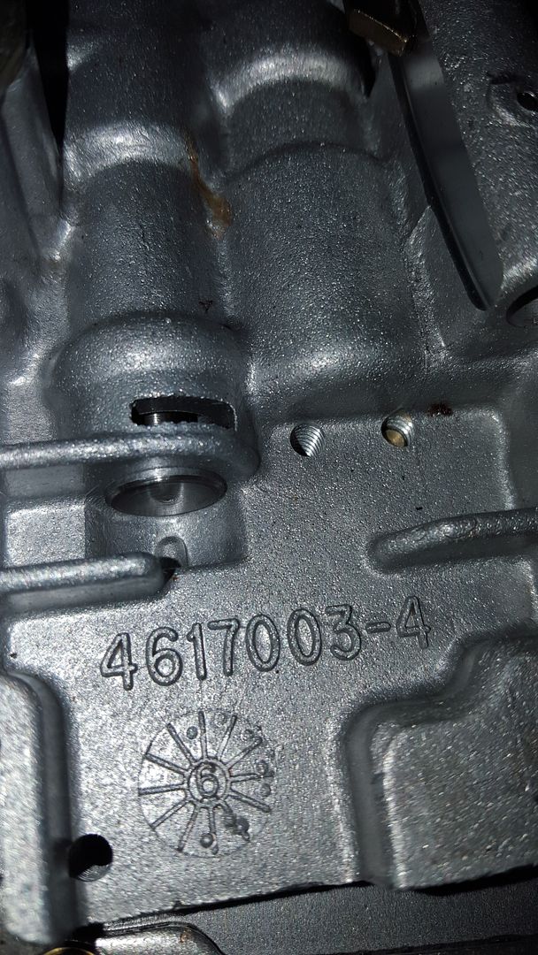

Here's my numbers

Those are the the factory casting numbers. They won't tell you how it has been modified. Look for a stamped number on the separator plate.
