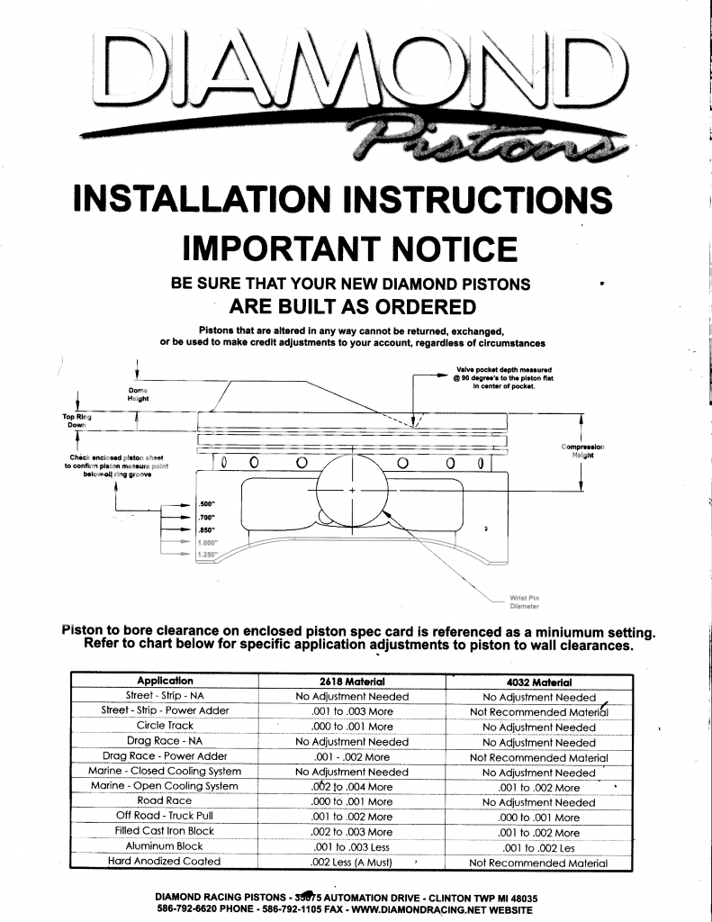

Pistons are really neat.....I do not know much about all the ring pack stuff, but these are very light....
My old 4.310 JE pistons weighed in at 741g and these new diamond pistons weigh 627g at 4.500"

Diamonds in a perfect world were 10.75-1 for my motor. when everything sorted out I was 10.4-1. Dave

i think i'm missing something here. what is the piston to wall clearance?
