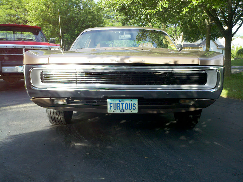

Looks awesome, great cruiser.
How about some pics of the car?

70 Sport Fury

It's gonna suck having to drag that jack and all the wood around with you.
Needs more doors!

That's a nice car. I think I have seen it at the Nats. I really like those two door 70/71 Furys.

Thanks! I've had it out to the nats twice
