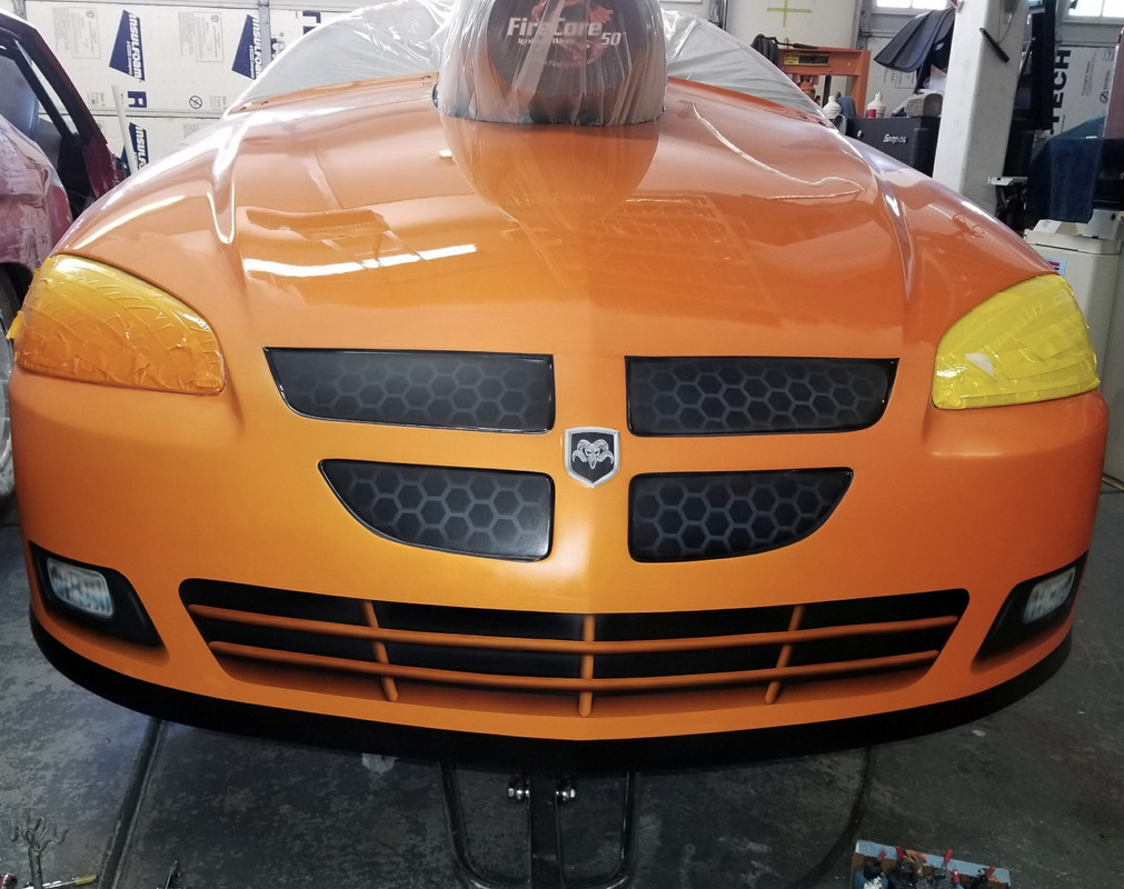

NO MONSTER SCOOPS!!!
Doing some changes to the car and thinking about a few options for a forward facing scoop. I’ve always been a cowl hood person because they look great on just about any car, make a car look more aggressive and work relatively well for the most part. Thinking about the following ideas:
1. New flat hood and forward facing scoop. I’ll have to find a nice one that isn’t HUGE to offset the balance/look of the car. Some of those scoops look ridiculous, especially on a smaller car LOL. I want the hood and scoop to be separate of each other.
2. Keep the cowl hood, cut it and incorporate a forward facing scoop. Hood would slide-on around the scoop. I’d rather they be separate and scoop/pan be 1-piece together sealing around the carb.
3. Keep the cowl hood, cut it and build or buy a pre-fabbed lexan scoop. I know of a few companies/shops that make them, and Mike at Comp Chassis builds quality ones as well. No mailbox sizes either LOL!
