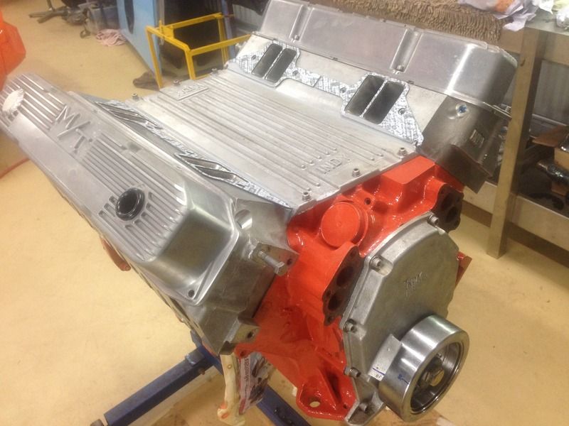

Hey guys, I have a 71 Barracuda street car that is loud, Im OK with the thump thump out the pipes it's the engine running/valve train noise it makes. It has always been like it, you really notice it when along side other cars or a wall, last week I had the shaker off for paint repairs and the extra noise coming from out the hood made me think there was something wrong internally. It is a 12-1 solid roller 528 RB, lash is around 20thou, mice custom extractors with 4" X pipe and Aero's. I have a tunnel ram but most of the time it has a 1050 dominator on it, unfortunately I dont have space for a air filter so I guess there is some noise out the carb as well . Today I am going to pull the slip collectors off, clean and add some copper sealant, see if that helps part of it. Would love it to shut up a little. Any tip's ?
