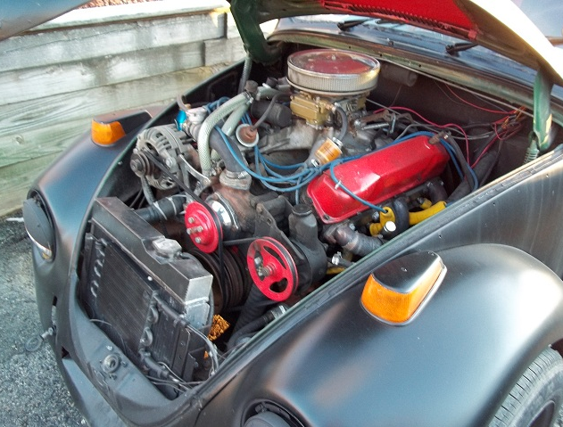

Re: Mopar powered Volksrod [Re: ] #1860512
06/30/15 02:15 PM
06/30/15 02:15 PM
Joined: Jun 2015
Posts: 17
WA
4
426W8bbl Offline OP
426W8bbl  Offline OP
4
Joined: Jun 2015
Posts: 17
WA
Kinda like that except my engine will be behind the windshield with a cover like a funnycar uses. Google image "Durachrome bug" to see what I am talking about. It was a funny car from the late 60s. The body on my "Backseat Driver" will also raise like a funny car. Just for kicks I am going to stick a monopoly money $100 bill to the engine cover with a note that says "if you can reach this with all eight barrels open, you can have a real one". Yes this car will have a passenger seat I can't have all that fun by myself!
