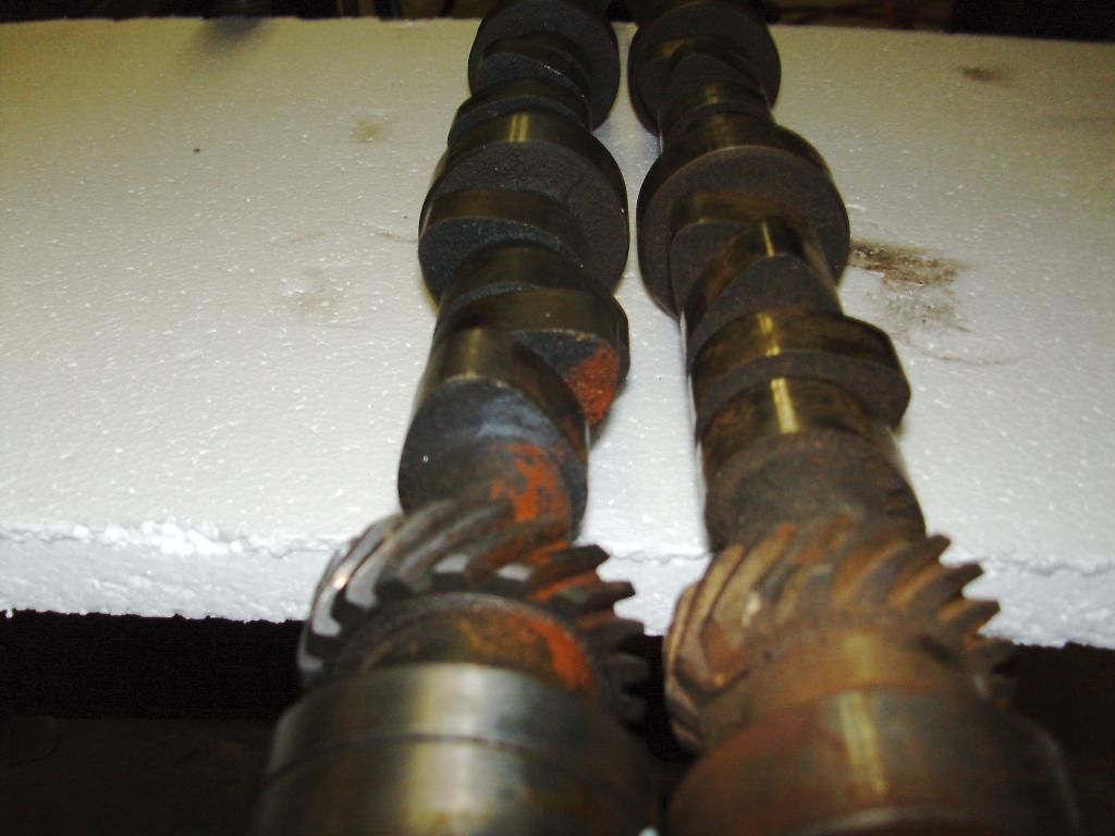

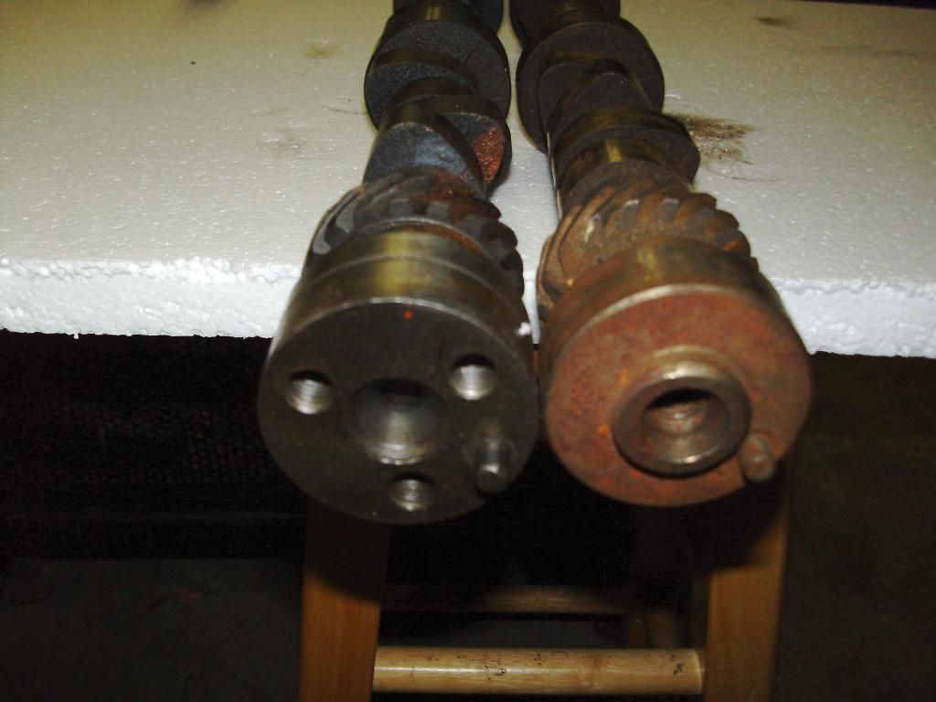

How can you tell the difference by looking at them?

All the Street Hemi motors had three bolt camshafts, the 440 6 pak motors had three bolt camshafts in 1969, I think the 1970 and 1971 6 paks did also The Hemi cams have the #1 intake lobe first, then the #2 intake lobe and then the exhaust lobes, the 440 are the opposite, I think. So if you hold the camshaft so the alignemnt pin is at the 4 o clock position and the first lobe is to the passenger side of the camshaft it is probally a 440, if it is the opposite it is probally a Hemi, I think I should go out into the shop and look at a 440 cam to make sure, huh. Its 20 F degrees out there and I got my jammy on, not tonight
It's no biggy but the 440-6 cam in 69 had one bolt and a nylon timing gear. 70-71 had 3 bolt cams and double roller timimg chains. I always use a 3 bolt cam and double roller timing chain on a rebuild or race setup but the 69 383/440's including the A12's all had the nylon timing gear.

Again....Thanks for all the replies. The main reason I made this post was because I had a guy bring me a bunch of old/used parts to rebuild a low compression stock 426 Hemi besides using a forged 440 crankshaft for on/off trailor car shows and light street driving use.
I did everything by the book, cept I didn't degree the cam, just installed it straight up. It was a 3 bolt by the way and on the old Comp cam box that it came in was marked Hemi in black magic marker. I didn't think twice about it. I couldn't use the new/used timing gear set cause it was too loose for my comfort and ordered a new -.010. Other than that I used all the peices that were supplied to me.
Now its the "shoot myself in the foot time" Took the engine to the dyno and guess what? The supplied 3 bolt cam was from a wedge.
Yup, I messed up, I'm human. Just thought I'd throw this out there. Leason learned, won't happen again.
