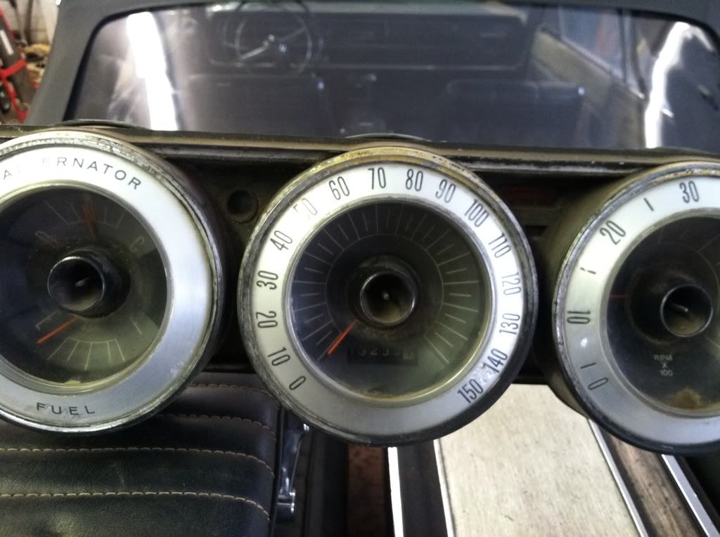

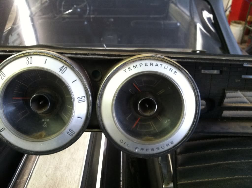

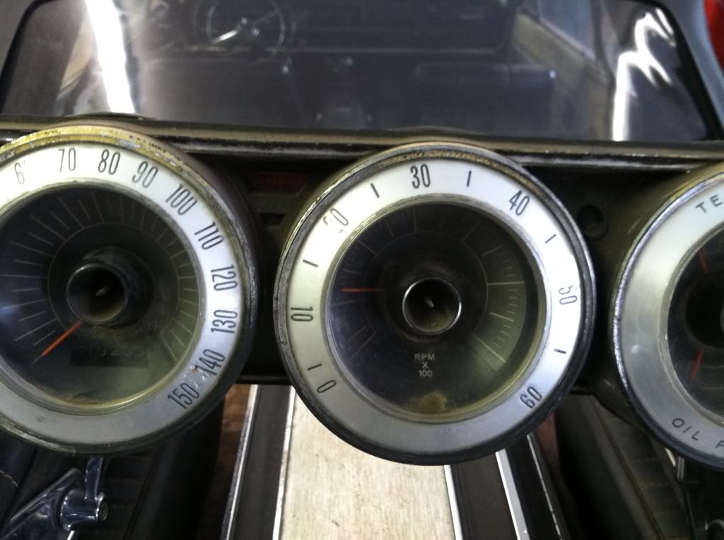

The power pak is just for the dash lights.The needles also have to be fairly decent as they glow when the dash lights them.They are knd of hard to see if they arent in decent shape.My kids 62 300 and the 66 Charger has them.I bought the last 2 new PPs that were in dealer stock a few years ago.Still have one as the kid stripped the Charger.Its a spare for his brothers 62.Rocky
Here they are Rocky. I haven't cleaned them up at all in these pics either..........I will end up taking them apart and clean them the best I can before final install

Dont rub the needles.They have a coating that glows when the light come on.Those look pretty good.I wish I still had the dash from the 66.Id post a pic of some that looked like NOS.The Charger only has 50K and was garage kept most of it life.Still bugs me that my son striped it.Rocky

Thanks for the needle tip Rock! Ya my needles look really vibrant in person.
