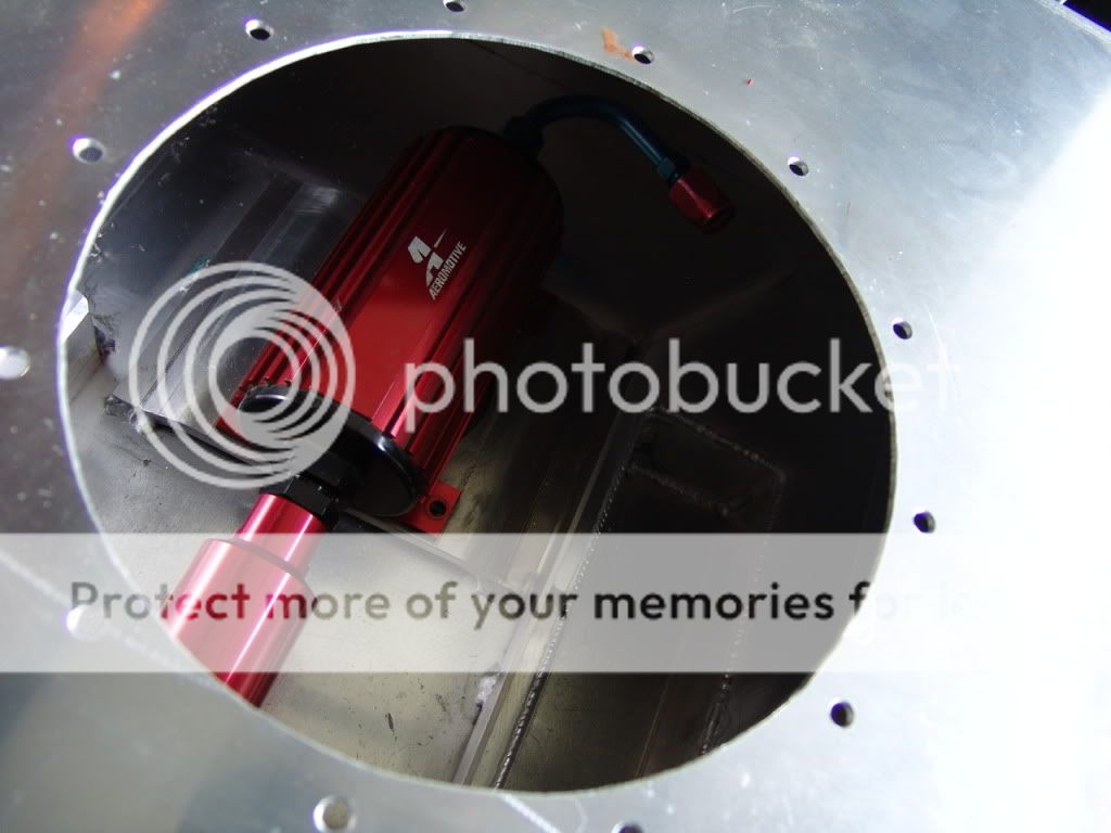

Well the welding bungs part he got right, but it doesn't have to be at the top of the cell necessarily. I coiled tubing inside and brought the return line in from the bottom front on the last fuel cell I had made. In fact, I used a aluminum block that had two 3/4 NPT holes in it and welded it inside the cell and inside there is a fuel line that is coiled that lets the fuel return near the top of the tank..
