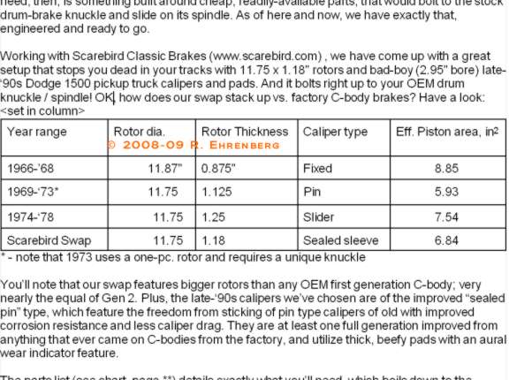

Here's spec. comparisons for the various C-body discs, factory and Scarebird (from the M.A. article). Note that any larger diameter rotors would require a wheel size increase. Rick E.
