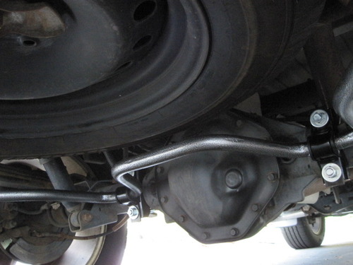

I'm sure it will be fine, but my particular truck has the bags mounted inboard of the leaf's, I believe the earlier Dodges were mounted on the springs themselves, but I could be wrong. Like, I said, I'm sure it will be ok, but wanted to make sure before I order them. I added a pic of the bags....

Humm that could get a little crowded. that's exactly where my sway bar brackets mount where the air bags are, I haven't seen that setup before! Nice!
Yours looks to be a 72-93 and visably diff setup.

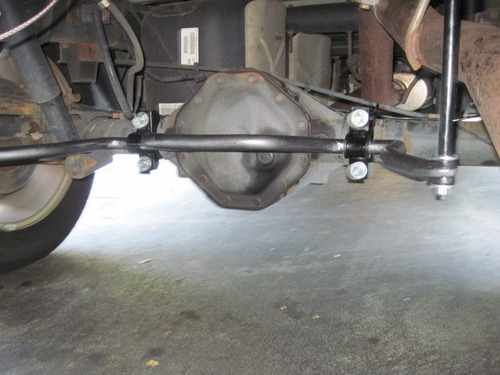

I found a couple of pics on Amazon where a guy mounted one on his 1500. Looks like the clamps are really close to the center section which is what I need. The 2500 bar looks to be the same one or at least the same shape.
Looks like itll clear to me if its the same yr and exact sway bar you plan to get.

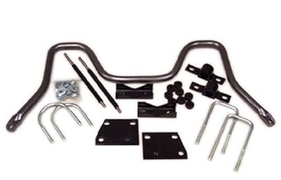

The pics came from a customer that bought the bar that is listed for my truck. So, I can only assume it is the same bar, plus it looks like the one they list for my truck a, Helwig 7651. But I guess to be safe I should give either Airlift or Helwig a call. Here is the bar shown for my truck...
