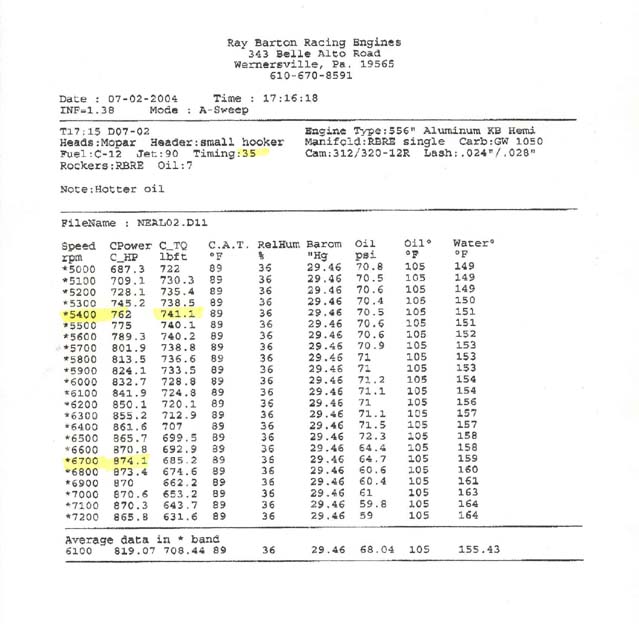

The alloy 557" Hemi was dyno`d at 874HP and 750ft/lbs , the car weighs 2750 on the line ,Bullet Racing Cams Int. 278@.050" / Exh. 284@.050 - .754"Int / .722"Exh.Comp Cams Roller lifters,Mopar Perf heads - Barton tweeked O ringed. RBRE 896 series S/S 2.250" Int. RBRE 896 series S/S 1.940" Exh.,it, has a light weight front half and has been back halfed with ladder bars and a floating 44" Dana 60 w/4.10 Stange gears, spool and axles and driveshaft w/ 1350 u-joints. I run 14.5/32/15* *Goodyears for rubber. The car has Wilwood discs all around , 12 point mild steel cage* . The front end including the bumper is glass , the doors and decklid also . The trans is a J.W. Perf. Glide ' with Ultra bell adapter , The Wheel flywheel , J.W. transbrake , and 4600 stall 9" converter. I`m using a Hurst Quarter Stick with pistol grip shifter also Hurst Linelock.

Not sure if you changed the motor from the prior owner but my records show peak tq is 5400 rpm. You need to have the flash about 100 rpm OVER the peak tq and this is especially true with a glide (taller 1st gear). Loosen that thing up some!
Jim

Nope didn`t change anything since the day Tweety picked it up from Barton`s . That`s the converter I got from JW when I bought the Glide c/w Brake converter and "wheel" all from the numbers I gave them .
