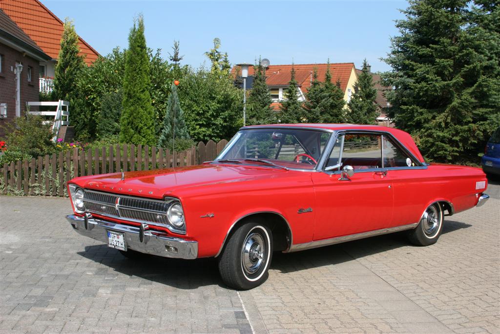

Thank you for your replies:
Now my Sat is too low at the rear.
Have a look.
Regards Flo
