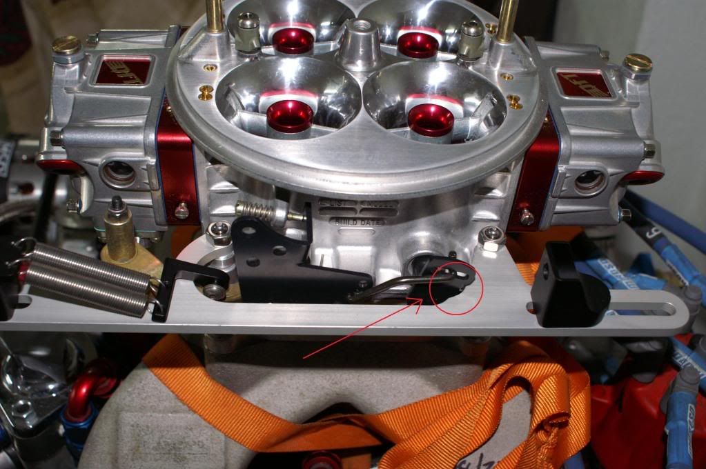

I have a Jeg's throttle bracket and I think it's a nice piece. Fits perfect under my 16" drop base K&N air cleaner.
I did have to put a small notch in the back (see pic) but that's no biggie, 5sec job max.
Getting closer... <img src="/ubbthreads/images/graemlins/smile.gif" alt="" />
