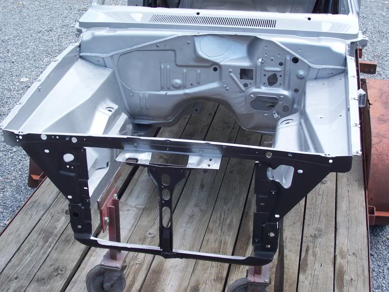

I just cut into the pass side inner fender and installed a piece of angle iron. It looked good and allowed the removal of the VC. Wasn't that much work for the body shop.
And I used stainless flex lines from the master so that it was easier to lay aside.
And I kept the torsion bars, too. Had to have several tubes custom made in the headers to fit.

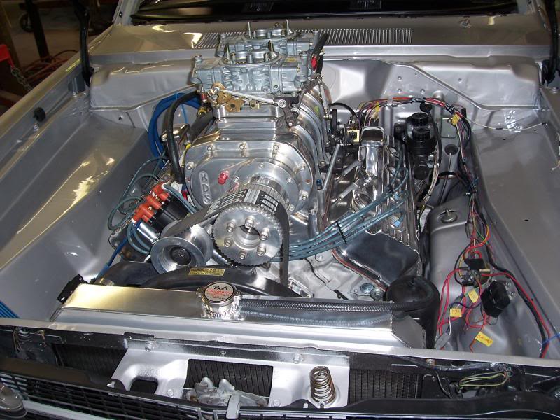

Thank you. Just what im looking for. Another gentleman told me it doesnt even need much clearancing, just a slit cut, hammer in and dress it up to look clean. Do you have another pic of the pass side with engine in? Nice work by the way.

I think this is what you need
And a couple of cases of beer and a box of Band-Aids!
I was considering doing a Hemi A-body years ago. I talked to some of the AH guys at Indy with original cars about the fenderwell modification. Most of them told me that they used a sledge hammer when they were built, and some got bondo to pretty them up and some didn't. shruggy

I looked for more pics of that area and haven't come up with any. Thank you for the complement, but it was the body shop that did the work. I just trial fitted the angle iron and cut enough to get the right clearance. It wasn't that much time for them to slick it up.
What master cylinder are you contemplating? I just used the late model O.E. Mopar one with the 4 bolt to 2 bolt adapter. Two nuts on the master along with the flex lines and the master was off and completely out of the way in like 2 minutes. Makes getting to the rear rockers on that side easier, too. Working around any master cylinder to adjust those rear rockers can require some gymnastics. And it is all cheap to boot.
