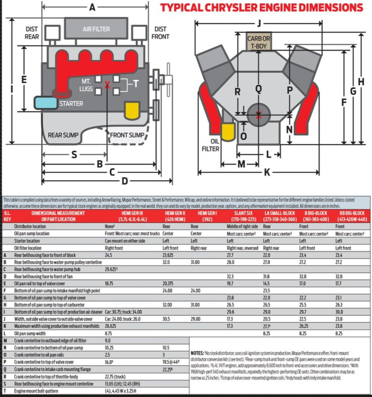

Hey guys, looking into swapping an old school chebby for a gen 3 hemi. Trying to avoid cutting the hood if possible, does anyone know the crankshaft centerline to intake flange dimension (on the head)? I've been looking at a couple choices for intakes, but space is limited.

[Linked Image]
