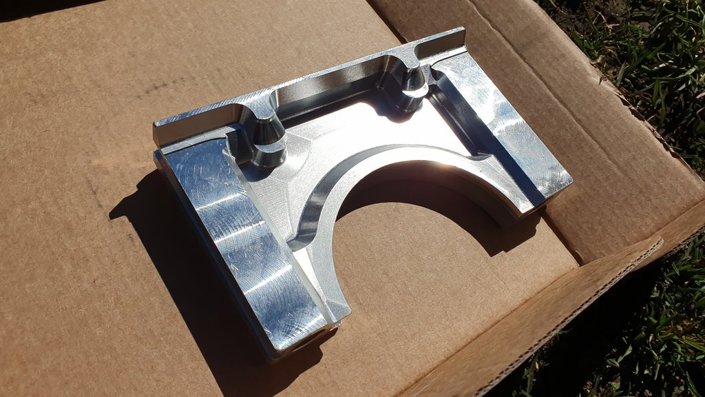

there was a thread recently that showed a billet retainer modified to resemble the engine side of the factory retainer. this acted as a deflector, throwing the oil back toward the pan. i'm too stupid to know when that was, or if i did remember, i couldn't link to it. maybe someone remembers this ? help out an old doofus with "oldtimers" and CRS please.

there was a thread recently that showed a billet retainer modified to resemble the engine side of the factory retainer. this acted as a deflector, throwing the oil back toward the pan. i'm too stupid to know when that was, or if i did remember, i couldn't link to it. maybe someone remembers this ? help out an old doofus with "oldtimers" and CRS please. Here's mine:

that's interesting. i have never seen anything like that. do you, by chance, have any pics of that pan ?
