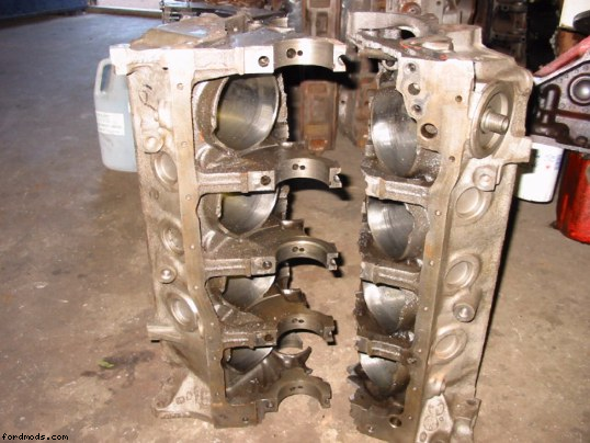

I think I read that BB stamped rockers will work on the SB victors.
On a side note, I split a 273 block from the main bearing to the cam bearings on all 5

I think I read that BB stamped rockers will work on the SB victors. I would have to have visual proof of this. As for splitting your 273, again, photos to back up your claim, please.

I think I read that BB stamped rockers will work on the SB victors. I would have to have visual proof of this. As for splitting your 273, again, photos to back up your claim, please. Back in 97 everyone didn't just have digital cameras everywhere so I must be lying.

Yes Dave, I have yet to see 525 pounds of cast iron "split" into pieces. Even if you tied it to a couple of D8 Cats in opposite directions I doubt you could tear any engine block apart. This from a former Heavy Equipment Operator and Metal Worker. There's a few videos of 2000hp, 100psi boosted tractor pullers shearing the head bolts off and throwing parts everywhere, is that what you were doing with the 273?
