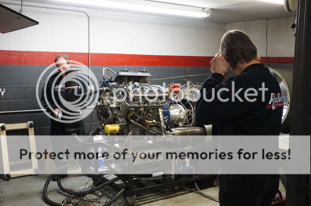

Well, I probably am leaving out some details, but a friend of mine built a similar engine as mine....And asked if would come down and watch it being dyno'd....Of course I said yes, and brought my Thumperized 1250 Dominator to try if we had time. Build specs: 572 Hemi Eddy heads Solid Mechanical 283 dur @50 .680 lift 9.5:1 World Block Intake....Depends! But probably a Six Pack.....Yeah, Sixpack Hemi! -We tried a heavily modified six pack on a Modman intake first...This is Rob's engine, and for anyone who does not know him in the Mopar circles, he IS Mr. Six Pack.....He has been racing these six packs on Wedges for so long, I don't think he could help himself and built one for the Hemi. I was very glad he went with the Modman intake on this build as well. -First of many pulls was with the sixpack...Lots of tuning went into it on a basic run in stand with an AFR gauge before the dyno, but without a load, its tough.... Best pull with it was 741hp & 666ft/lbs....lots of tuning to get it there. Still needs work as the transition was blubbery with the vacuum carbs coming in...I prefer to run three mechanicals over anything vacuum, but I am sure he will figure it out. Vid.............: https://www.youtube.com/watch?v=ueC_4nAdSZ4&feature=youtu.beNext was the Promax 950 Dyno mule carb he had....Not sure what was done, but we made a bunch of pulls with it changing air bleads, timing, etc and netted a best of 749hp at 704ft/lbs... Vid.......................: https://www.youtube.com/watch?v=5QjkTW-o1QY&feature=youtu.beNow we get to my 1250 G3 Holley that I had Thumperized.....Now it has not had fuel in it since the conversion....It was a 3-circuit and I could not make it work on my 605...Had it converted to 2-circuit, and never touched it! Fired right up to a perfect idle, and then mad 779hp & 717ft/lbs of torque....No adjustments other than floats.... Vid......................: https://www.youtube.com/watch?v=M5l_w8n8gbE&feature=youtu.beThanks Mike at Jan Cen Racing and Rob Brooks for inviting me....

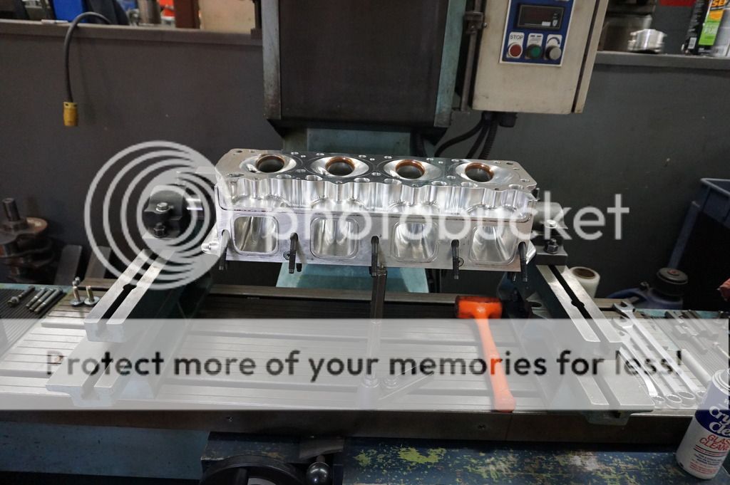

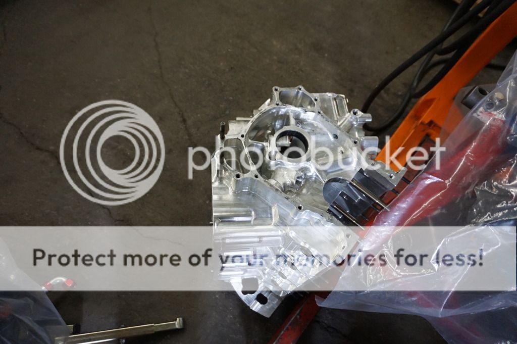

Not sure if anyone on here has heard of Jan-Cen Racing or Mike Janis, but those guys are Pro Mod gurus....I saw so many high end blowers and Hemis today all over the shop....Amazing..... Here are a couple more pics.... ************************ A torched Seal 4-Good Exhaust gasket from Rob's motor on the run in stand...Ironic really!*********************************

Not sure if anyone on here has heard of Jan-Cen Racing or Mike Janis, but those guys are Pro Mod gurus....I saw so many high end blowers and Hemis today all over the shop....Amazing..... Here are a couple more pics.... ************************ A torched Seal 4-Good Exhaust gasket from Rob's motor on the run in stand...Ironic really!********************************* My block is there right now..lol

Predictable results from the selected carb and manifold combinations. Six Pack was actually closer to Dominator than I thought it would be. Would have been interesting to try single top on Mod Man, just to see results. But would only be a research project as doubt anybody would use one for that I actually thought the Dominator was too big for this motor, but I had it sitting on the shelf waiting for my 605 to be finished up. AFR on his motor was right around 12.7-13.0 and he used ethanol free fuel. So it seemed right in the ball park and we just left it that way. What you can't see is how bad the six pack was where the outboards opened in the mid range. The AFR jumped all over when the opened. A couple of the pulls it was real noticeable. I do not have a copy of the dyno sheets, but you might be able to hear it in the vid. It stumbled every-time. The more we messed with it, the more it seemed to get a tad worse. First pull was the best. And the engine was the coolest. Bringing it earlier seemed better. It did make the Hp though....I would loved to have tried three center carbs.

I know Mike very well.. surprised you didnt jet up on that 1250... all in all a good day on the dyno congrats
