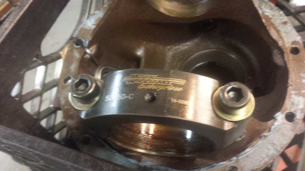

Don't listen to these guys....The weakest part of an 8.75 rear is the stupid adjusters which is a bolt in the center of the cap. The billet caps from MW will make your 8.75 a much better piece and it's more the Enough strength for 90% of the mopars out there. really not even close to being the real problem with an 8- 3/4

Don't listen to these guys....The weakest part of an 8.75 rear is the stupid adjusters which is a bolt in the center of the cap. The billet caps from MW will make your 8.75 a much better piece and it's more the Enough strength for 90% of the mopars out there. Not sure exactly what "bolt" you're talking about? The adjusters, which are threaded discs on either side of the carrier don't change a bit moving to steel maincaps, and they certainly are not the weak link in an 8-3/4. The steel maincap (really needed on the driver side only) certainly do make the 8-3/4 a better piece, but still not applicable to a 500-cube, 4-speed, B-Body (IMO).

Don't listen to these guys....The weakest part of an 8.75 rear is the stupid adjusters which is a bolt in the center of the cap. The billet caps from MW will make your 8.75 a much better piece and it's more the Enough strength for 90% of the mopars out there. Me think you mean the stupid boss for the retainer bolt for the adjuster, yes? The left(driver side) cap usually breaks at that boss first which destroy a bunch of other parts, been there, done that The last 8 3/4 I built and raced ended up bending the housing bad enough on the passenger side to rip the ladder bar mounts off it during a run at the starting line, NOT GOOD OP, if you do decide, or anyone else who wants to drag race a 8 3/4, do what ThumperDart did, add a backbrace before starting to race it

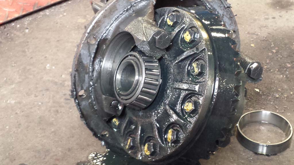

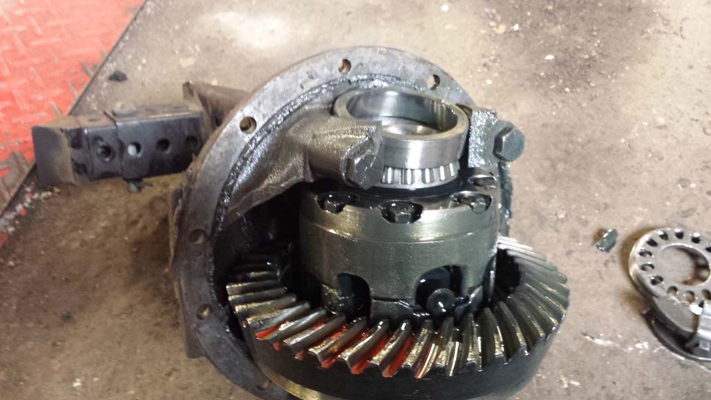

Your just as well off to take that billet cap money and light it on fire..........does about as much good. The cap is NOT the weak link
You will NEVER fix what is wrong with an 8.75. It flexes the case, which causes ring gear to move away from the pinion and shells teeth.......THEN, when all that carnage gets going in there running over itself, it breaks the cap. When it is trying to turn with gear teeth piled up on top of itself, SOMETHING has to give........it's usually the cap. So yeah, you can put a cap on it, and when it DOES shell the teeth, which it WILL, you still have a bunch of broken parts, in a rear with some really pretty, expensive caps

First, let me say that the car in question would be better suited with a dana. I don't agree with the forensic explanation by Monte though, and here's why. I was breaking ringgear side caps on mine(3 times), and also seeing chipped teeth. Had I stopped there, I would have agreed with Monte's explanation. I went with a heavily gusseted housing, and added cap support load bolts. Still using the factory caps. I no longer broke caps, or chipped teeth. The failure at that point was pinion shaft shear. After 2 episodes of that, I went with a strange ultra case 9 with 35 spline pinion. Never even had to think about the rear end again. 8 3/4 has its place. But it's not under the car in question.
