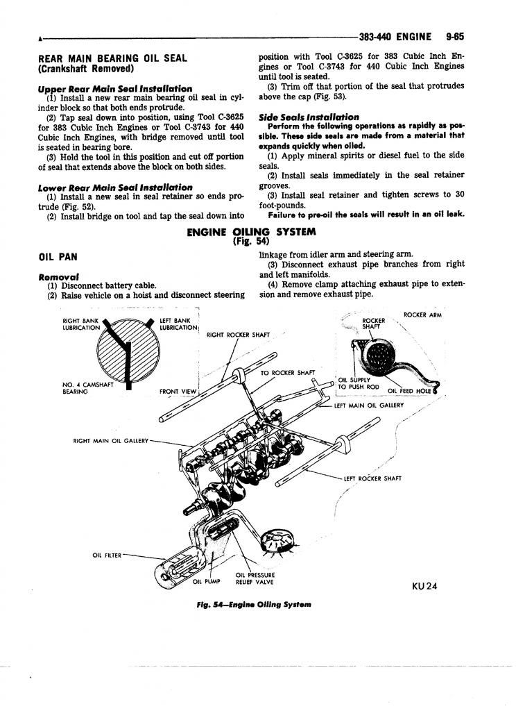

This may help.
[image][/image]

By the illustration, I wouldn't have come to a conclusion to rotate the crank and I couldn't find anything in the service manual to state this fact of rotating the crank. The motor is complete fresh, no carbon build up here...
