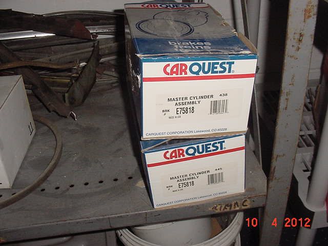

I did this same thing to my 71. But I used a MC from Car Quest that was made for a 71 with power disc brakes. Both of my cars have power brakes even with heathly cams. I used a Ebay used propotioning valve for a 71. My system works great, it has 11" drums in the back. I know you don't want power brakes, this is the part number I used on my cars. I sold a number of these on E bay years ago and would buy 6 at time and resell them. I've read here that there has been problems with new propotioning valves, like I said I used used valves and they work fine with no leaks.
