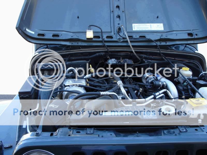

If you are going to go with a basically stock engine - a T4 with 60-1 HiFi compressor with a .84 AR turbine works very well. A 35mm wastegate is about all you will need. You can also run a cheap Bosch blowoff valve to keep the cost down.
If you run an aux fuel pump inline with a 12:1 FMU it will be just about perfect with the stock injectors as long as you aren't going for more than 7-8 psi of boost. If you plan on upping the boost more than that, then you will need to upsize to 24# injectors and run a 10:1 FMU plate. The MAP sensor will need a checkvalve / bypass to vent boost but close when in vacuum. The power brake boost check valves work well for this. Move the IAT sensor to the air filter in front of the turbo. An intercooler will help it run on 91 octane in warmer weather and is especially important if you want more than 7-8 psi of boost. If you go to higher boost than that, a boost retard on the ignition is recommended.

No, not my Jeep. I turbo'd it for a customer 4 years ago. His Jeep was almost glacial at 8,000' altitude so it needed some serious help. He was so friggin' happy with it he was almost beside himself.

Duner I know it's all relative but what's a ballpark figure on a build like that?
Can OBDII candle this or is a FMU mandatory?

judging by the pcm in that pic its an obd2 truck...my donor is a 94 cherokee 4.0 with 150k on it...for now id like to keep it as stock as possible? Did you just run the factory manifold on the left and pipe it over to the pass side to mount the turbo? I dont plan on running more the 7 or 8 psi I Dont think the engine would take it...not saying in the futurea stroker with forged guts couldnt happen...but hey im playing with gremlins so not like im rolling in the dough right now...

That was about a $2,500 job.

Yes. It was pretty much all stock including exhaust manifold. The Jeep exhaust crossed over to the passenger side from the factory, so I just redirected it to the turbo, then tied back into the stock exhaust system out of the turbo. Just the aux pump and FMU for fuel duties. I also built a heat shield for the turbo to keep from cooking the battery in the stock jeep location.
