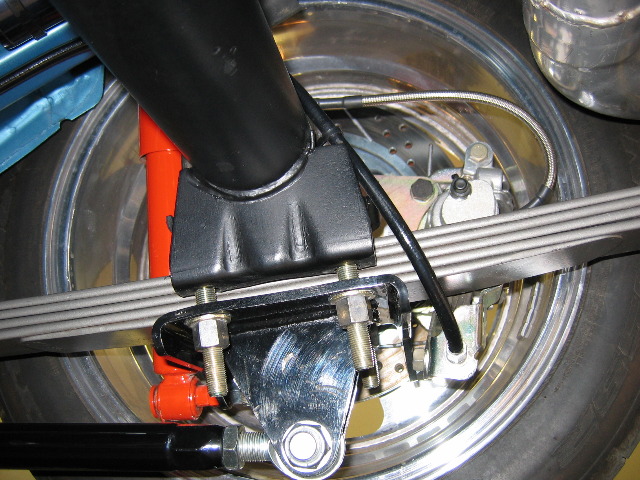

Have you considered something like this Street Lynx system A Body Joe just installed?
https://board.moparts.org/ubbthreads/show...part=1&vc=1
This is a very nice set up. while the coil over change allows a greater range of spring rates and the link arrangment is somewhat lighter than leaf springs, it doesn't have any adjustment in it for roll center alterations. Not that this is a big deal for most guys as once it is set, they learn to live with it and they never run it in varying track conditions that require tunability. However, with a few simpler mods than this system requires, leaf springs can be set up to have changeable roll centers which can then be used to alter the amount of rear bite you need in your set up.
