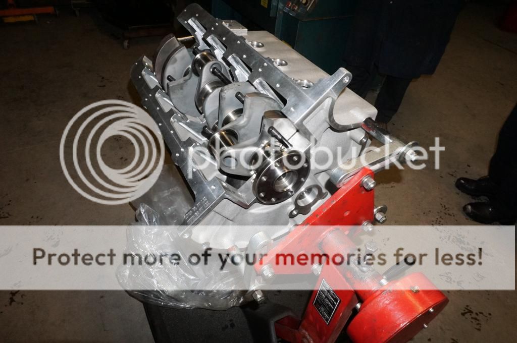

We are learning a few things during this build... Heads: It looks like I need to go to standard length spark plug tubes instead of the long ones I had used on my 426-1 heads...The long ones definitely don't fit and we pulled a brand new MP set out of the box and those do fit. So there went another $100... Cam seems like it wanted milder springs than the heads came with. Heads are set-up for 240 closed, and 420 open if I remember right. Or basically a +.700" roller cam.. While my cam only needs 140 or 150 closed, forget what it needed open. So I have a lot more spring than I need, not sure if I will change them. One nice thing that was noted was they are smaller in diameter and should clear standard valve covers better if that was something someone had to have, but we don't need...Still need lash caps as I forgot to order those, nother $100 I am sure. They check out very good when vacuum checked for sealing and blued up to check contact area. There is also a big increase in flow as I had a local shop flow them. Only thing that concerns me with fully ported 16 bolt heads is the lack of sealing surface between the bolts and intake ports...If this becomes a problem, all my intakes will be for sale to switch over to 10 bolt intakes as the heads are drilled for both. RTV is going to be my friend it seems. We did notice some inconsistences in the rockers stands though. We are still mocking it up, and where they are pinned is not always correct. We have a set of OEM Cast Iron ones that line up perfectly so we know its the stands. Block: Is looking real good. Crank is in with one piston and rod for checking...We had it clearanced for the 4.75 stroke, but we have a ton of room around the rods. Looks like it was clearanced for aluminum rods as well. No biggy. It was taken apart and thoroughly cleaned after hone. We noticed with all the blind holes none seem to be drilled so deep as to break into the water jacket or the crank case area, so no thread locker/sealant is needed...Very nice change over the World block. We also drilled the valley oil return holes at the front and rear of the block bigger since it is a street engine. And man is it light! Cam bearings fit the cam perfectly as the cam is already in. The pan rail is also very large, should have thought about the optional machining of it more.

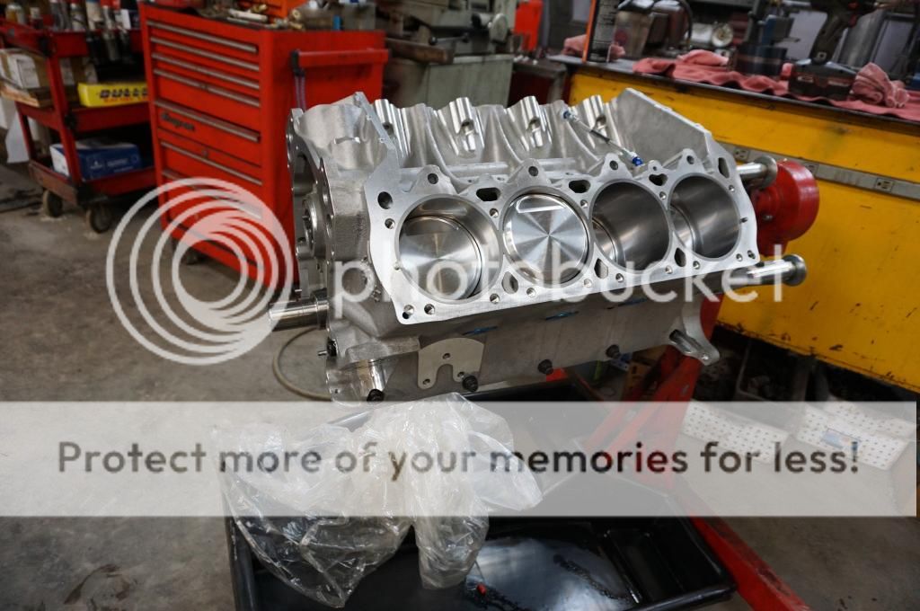

Well...More progress. The block is assembled with all the pistons, rods, rings, and the crank and cam. Getting ready to degree it in this week.... So the first question is, where do we install it? We are thinking putting it in just as the cam card states, but I want to hear some opinions. Also note, I am using Indy rockers and they have a higher ratio than OEM at 1.60 & 1.55 compared to 1.55 & 1.52 if I remember right... Block progress was good until we got to the lifter bores last week. We had the crank in and one rod and piston when we found all the lifter bores undersized and especially tight at the bottom. Ron re-bored some and then re-honed all of them to size...Indy's catalogue says they are finish bored, but we found otherwise. Can't wait to pay that bill.... Also, I have decided to plumb an accumulator off the right front lower oil port just to the right of the timing cover. I will mount it to the engine plate and hopefully keep everything simple. I have fought oiling issues on my last two builds and do not want to take any chances with this one. Heads are also assembled now, but the question remains, should we run this cam with springs that the heads came with which are #230 closed pressure when the cam only requires about #150 closed...I am thinking it might be worth switching...What say you guys?

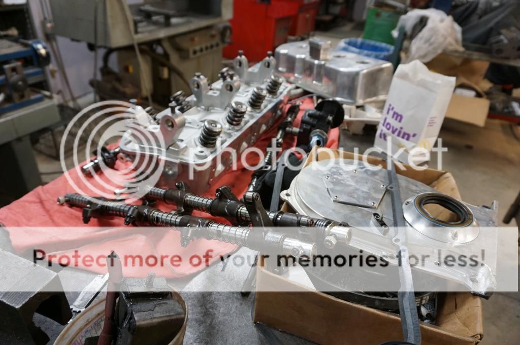

My engine builder is on vacation, but yes the build is almost complete. Cam is in, pistons are in, everything is degree'd in...New inner heads studs showed up along with Cometec gaskets. Three builds, three different length inner heads studs. And the lash caps showed up.

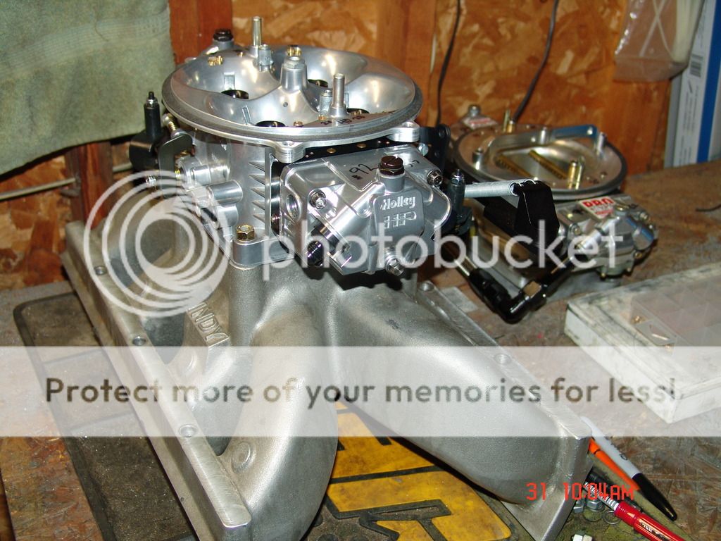

Lastly, the new carburetor showed up, and I picked up a used large plenum intake...We were deciding on an oil pan and I think I have that picked out, so the old one is for sale. And we did run into a small snag on the push rods.
We measured up for new push rods and I was going to order a set, the we noticed our checker is not fully seated in the lifters. The lifters I have require 5/16" tips, so I need to borrow a checker with a 5/16" tip to get the lengths. Friend of mine offered, I just need to go pick it up.
So I need push rods, an oil pan, accumulator, and a hood, and we should be off to a dyno...hopefully.
The carb I got I went with Holley due to my previous experiences with Pro Systems. Both my previous carbs from him were way out to lunch...Well, I got a Holley 1250 G3 and it was wet flowed, and I took it apart because none of the jetting was documented anywhere....
First thing I figure out, they switched the intermediate air bleeds with the idle air bleeds, and me never having a 3-circuit before, figured that out....Next, it has a power valve in the front, and I do not run those in any of my carbs...and what they have the intermediate circuit jetted is way off the range I was told to run, so I need to order some jets and bleeds. Luckily there a few people out there with this combo and I have a baseline to start with...I miss EFI!

New carb showed up....And I picked up the new intake...Its big!

Looks great, Randy! Best of luck with your new bullet! FWIW, I ran the Comp Cams 829 roller lifters in my 528. Logged thousands of street miles with no issues. Cam lobe design has a lot to do with it.
I have also run those with no issues, but one of my racing buddies sends his lifters back to Comp for rebuilding, and the last two seasons 3-4 come back brand new as not repairable. He said they used to all get rebuilt with no issues, but not the last couple of seasons...I know of others that had issues as well. I can always go roller with these heads later. I actually still have that crazy .750 lift efi cam I could always put in this thing...

That sounds like a lot of spring for a flat tappet. Is the cam or lifters specially hardened? Not criticizing hear, just haven't heard of that much spring on flat tappets.
Yes they are hardened...I am told, they really don't need a break in , and I can go cam to cam with them....Apparently, they have logged many thousands of street and strip miles on these with very good results and little to no failure in a lot of big inch Hemis...Give him a call if you don't believe me. I have a friend that lost his 493 at the end of the season due to a roller lifter failure...I am not going there. My buddy is running it in his 572 hemi, so it can't be that bad.
Good info. Being able to run springs like that, rpms ought to be no problem, course, your gonna have enough torque to through the earth orbit off a bit

Was lucky, we had a set of milder springs down at the shop....Right around 145lbs closed, and we pulled the big springs off and swapped the milder ones on....So now we should have everything matched up properly.
Heads and chambers and valves were all checked for clearances to the pistons, and we are a go for final assembly. Very happy we did that as a big thanks goes out to Ron yet again.
So we are getting close to getting it on the dyno now....First points race is next week, so we can't go that weekend, but soon hopefully.

Ok....So I built that motor last year, and I wiped out a cam lobe at the end of the season. It was a solid mechical cam from Bullet and RBRE Tool Steel lifters.....Lesson we learned, remove the inner springs when doing cam break in. Low oil pressure at an idle probably wasn't helping.
So this gave me the opportunity to work on it this winter. Some internal upgrades were a re-line honing the mains. We had low oil pressure at idle after it was warm, and we found some excessive clearances. We had the caps dusted, and set clearances at .002-.0025"....Now we got oil pressure!
Next was the cam, I priced a mild cam similar to what I had, but in a roller....It would have been another $450...So I had an old cam holding a door closed laying around we looked up the numbers on. After a lot of discussions and back and forth, I decided to put the old cam in. It was notorious for eating push rods, but it was free, and was in the performance range I wanted. So in it went.
Now it says .738 lift, but recalculate that for the Indy roller rockers, and we are at .752 lift!

Well, its been a little slow going, but the block as shown above is fixed and needs only some good clearance checking and cleaning and it should be ready to go, and this week, the crank came back all fixed....Thank goodness. That would have been expensive to replace. So now if AJ Casini will just return my call, I can get an idea on the replacement parts I know I need. And where do I get one of those oil filter plates that will sandwich in there and allow me to go to a accumulator?

Well the short block is going together nicely this year....I have a billet rail oil pan in the works as well, and need just a few more parts yet. And, I landed a new job!

Well the short block is going together nicely this year....I have a billet rail oil pan in the works as well, and need just a few more parts yet. And, I landed a new job! Right on man on both counts, new income and outcome at the same time..........
72 Dart 470 n/a BB stroker street car `THUMPER`...Check me out on FB Dominic Thumper for videos and lots of carb pics......760-900-3895.....

Whats up with that oil filter??? Its a K&P Engineering re-usable filter. I have a couple of them I bought from Ray Bartons shop. I like these a lot better than others I have used. And sanwhiched between the Milidon pump & cover and the oil filter is an adapter to go to my Accumulator One of the things we have learned about Hemi engines with aluminum blocks is oil control, or lack there of gets you in trouble quick. What you can't see this year is we modified the block ports that feed the heads and put restrictors in those. We had much debate about the size to use and settled on .070" holes in them. Also the Ohio Crank boys did an awesome job on the re-work of the 4.75 crank. bearing clearances are set at .0015-.0025...Bigger and you will have less oil pressure than optimal at idle. We had to re-hone the crank bore in the block because one journal was bigger and then tell the guys at Ohio Crank what our sizes were. Its spins like glass on wet ice in there....

Looks nice, but that sounds awful tight on the bearing clearance.

Looks nice, but that sounds awful tight on the bearing clearance. THIS!!!!

I have .0024" on the rods w/ coated Clevite bearings and .0035" on the mains w/ regular Speed Pro 119M bearings. No problems w/ idle oil pressure. Only reason the rods are as tight as they are is due to the coating.

The good news is, I can take a picture of the inside of the oil pan now for you. The bad news is, the rebuild didn't make it 10 miles down the road before major issues occurred.
So I got the engine running a few weeks ago, and it was in the car about a week. Went to take its maiden voyage down to the corner gas station and back, just to feel it out and put a few miles on it, and half way there, oil pressure started dropping.
I just happened to look across at the gauges and finally saw full engine temp and then looked over at the oil pressure, and it was already down to 45psi from 82psi....WTH!
Pull over and call a friend for a tow, no one answers...Fire it up and drive home, and it was down to 10psi if I am lucky by the time I pulled it back in.
So to make a long story short, I pull the engine a few days later and get it down to the shop. Pulled it apart, and struggled to find anything wrong.
Seems the crank we just had repaired, went and sprung once it reached full temp. That's the best explanation we can find. It was out .003" and I know it was straight when we put it in. Called Ohio crank about it, and they said that can happen on repairs like that.
So now, I am out my summer car, as I do not yet have a spare engine built. And I am wondering what my next move is....
Called Bryant for a crank, and its 14 weeks to get one...Still waiting to hear back about a Callie's for lead time. Might just sell it and build another 400/512 or a G3...Pretty depressed about it. Two summers in a row and Mopar day is this Saturday...no cruise nights or car shows this year either...

Well, we straightened the crank again, and it now has only .0001" runout....new bearings are here, so we sent it all out for line hone, again...
Then, its ready for assembly....again.

Well, after a long delay, many discussions, lots of disappointments, I have found some hope in plan C.....
I am going to pick up a brand new block hopefully this Saturday.....Got the cash in hand, and the guy still has it. So a road trip it is.
So with that said, I pulled the running engine out this weekend to start the tear down and see what we can learn from it. Probably not much unless we go all out to pressure test every passage.
I went thru many different ideas and options this year in looking at my problem, and realized that the lack of parts for the old G2's is really not fun anymore unless its a show poodle.
I was willing to spend some money to end this issue once and for all. But in my searching, I realized it might be time to switch to somthing else. The lack of blocks and standardizing is killing the after market right now. At least in my eyes.
For those that didn't notice my add in the race section, I fired up the fresh 605 just after the new year, and again, oil pressure was an issue. After about 20min of idling, it was down to 10lbs...Same issue as before. I was really looking forward to enjoying this car a little this year, and time after time, its just a money pit...But I see some hope in the near future...

Well, first I was willing to buy a complete running engine, and KB and Indy stuff does not interchange well if not at all. In fact, even some of the KB stuff doesn't interchange with KB stuff depending...This makes things very difficult for people like me...
Then I looked at maybe a billet water block...Same issue, long lead, custom built to order....Still looking at G3 options. I really like the Hellcat crate. And that is kinda my plan at the end of this season is to buy one of those if I can swing it after this mess...
Here is current plan C...
