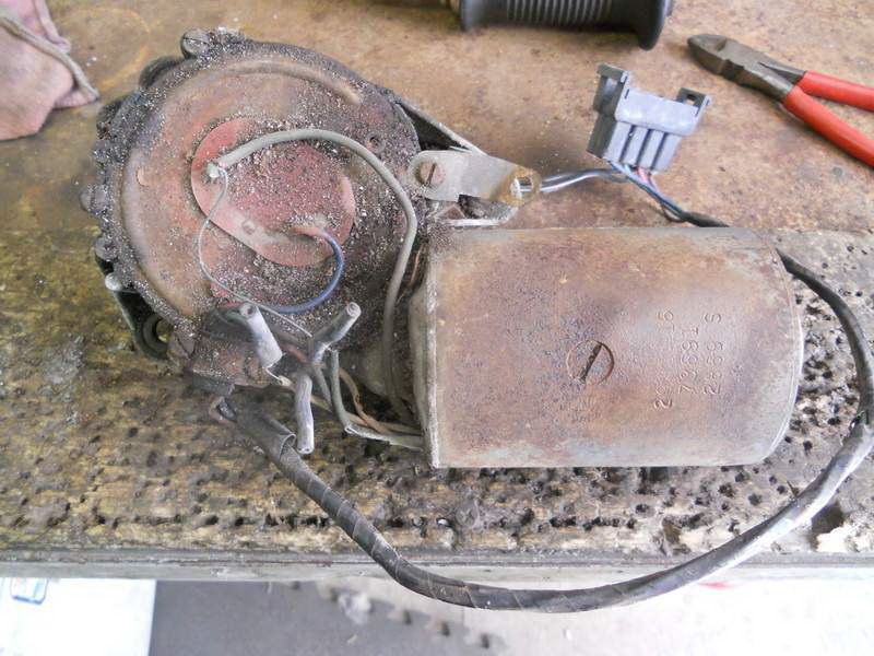

A couple E body motors I've received and restored
And another one, in a little rougher condition (owner supplied an "extra" switch plate/gear housing cover)

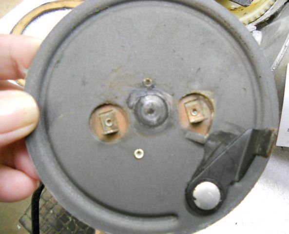

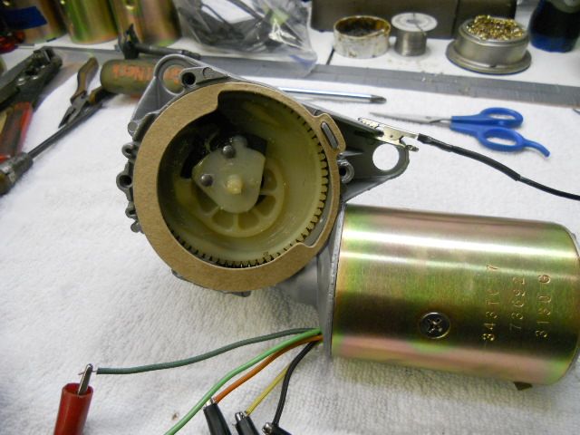

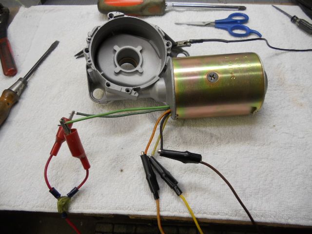

Thought I'd steal some time and post a few photos of a motor IN progress. Once I've tested for all speeds and park I add the wiring harness and move it to my table to add the sealant and it stays there until the sealant is dry. At that point I add the harness hold down, ground strap, grommets and firewall gasket, mounting hardware and it's ready to box and ship. This was the build of a restoration of an original motor for the owner. I replaced the switch plate which was broken from my inventory in this particular instance.
Testing for Park Function

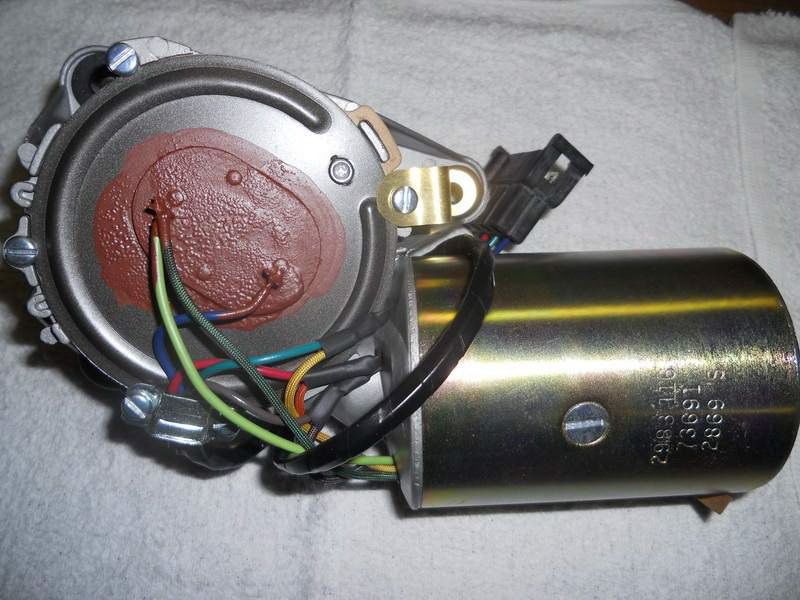

Set up For Sealant and Drying

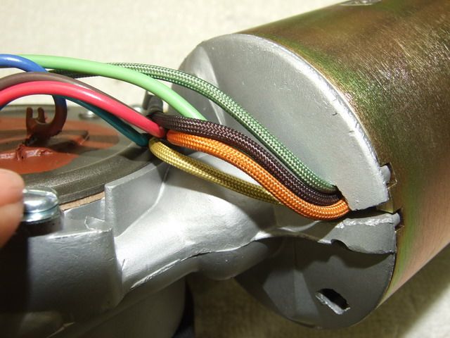

Photo of wire covers. It took us many many hours to locate and procure the fiberglass sleeving that we use on each motor. It's high abrasion resistant, resistant to engine fluids, etc., and can with-stand temperatures up to 650C. Cut and dyed by yours truly and thus the reason several times a year I walk around for days looking like Walt Disney threw up on me (I custom mix my dye colors to as closely match the OE colors as possible).
So there it is in a nutshell, a wiper motor in progress. The motor beside the restored motor on my table is a repair.
We also do repairs if someone's budget it limited and they're ok with the way the motor looks, they just want it to work and have covers on the wires, etc. so the motor functions as intended.
